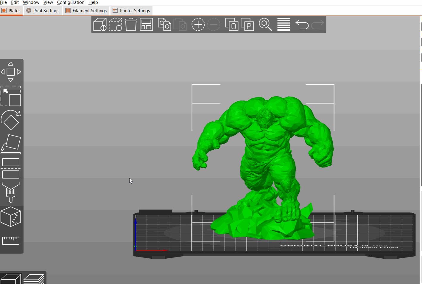

Measurement tool
The new measurement tool in PrusaSlicer 2.6.0-alpha2 "recognizes points (vertices), edges, circles and planes" and allows you to take measurements between these. Additionally, it allows you to pick a measurement and scale it – and the rest of the model along with it – to a desired length.

Cut tool
The cut tool got some advancements as well. In 2.5, PrusaSlicer allowed you to make perfectly horizontal cuts, but cuts in other orientations were cumbersome, because you had to rotate the .stl, make the horizontal cut and rotate the part back into its original orientation. The cut tool in the 2.6.0-alpha2 version allows you to make cuts in arbitrary orientations.
